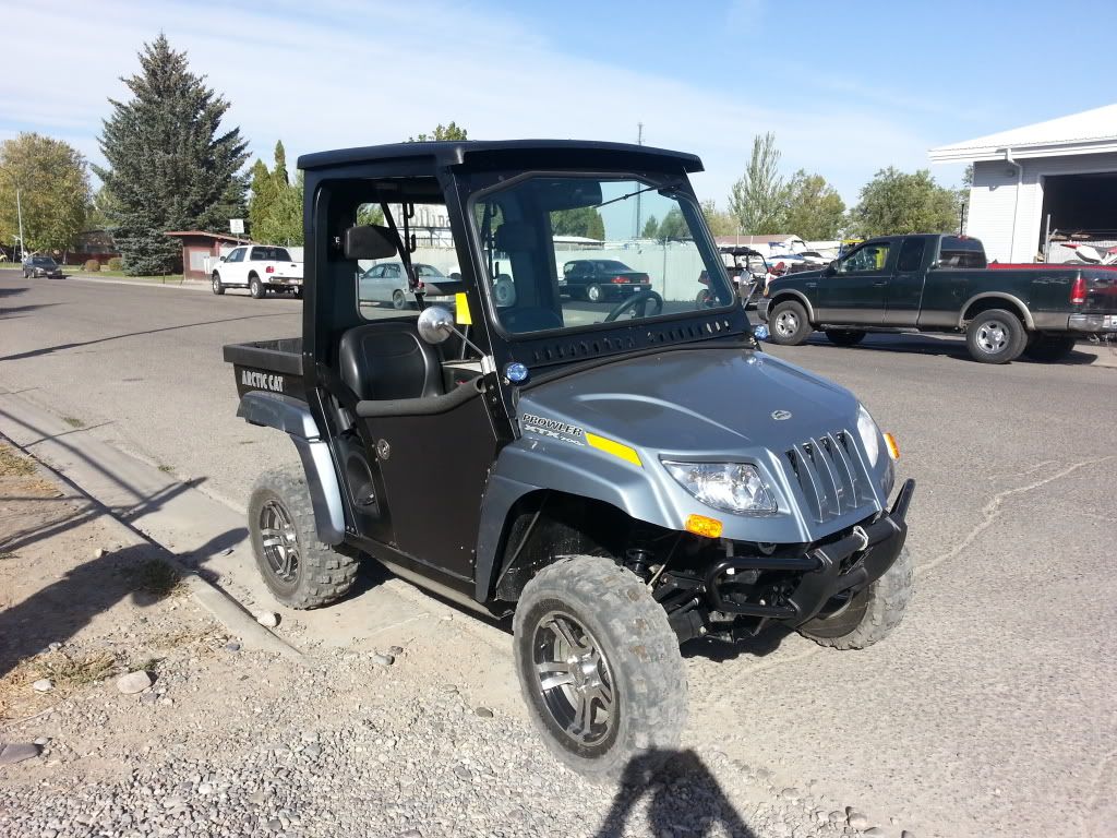

I recently received the "thumbs up" from my wife to shop for a new UTV. I was on a budget so I knew I wasn't going to be able to pick up a brand new brand name unit like a Rhino or such so I initially was looking at picking up one of Cabella's Coleman Outfitter models which was a Rhino knockoff. That was until my brother sent me a link to an Arctic Cat Prowler that Action Motorsports in Idaho Falls was selling. They had the price listed at $7599 and it came loaded to the hilt with add-ons and only had 1739 miles on it. I talked the guy down to $7299 over the phone, dropped a $500 hold deposit on it and made the 5 hour drive from Boise to go pick it up.

So my next step was to put an expanded roll cage on it and chop the cage to allow it to fit in my cargo trailer. Since I didn't want to spend $1400+ on an expanded roll cage, I enlisted the help of my brother who helped design and build the cage for me as well as do the cage chop. Overall, I was only out $300 in material to buy the steel tubing, expanded metal and all the consumables. In the process, since I wanted to have access to my kids in the rear seat, I also ditched the rear window.
