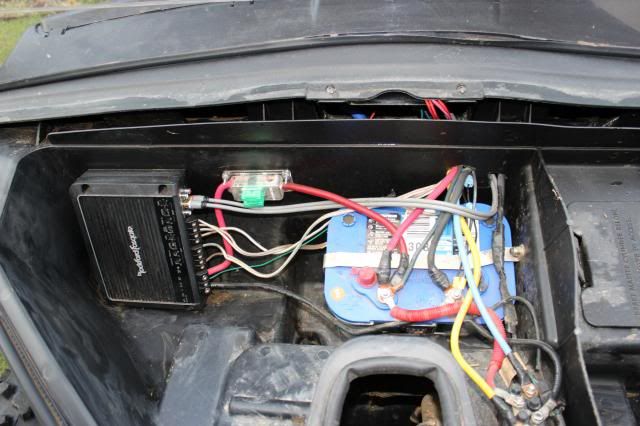

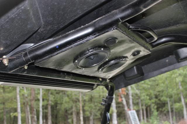

I am also adding speakers under the seat, a 8" sub will fit perfect under the driver seat. Relocating the battery to under the hood. Running 6.5" under the roof, put amp in the front with a aux input and volume control knob. Ill post some pics

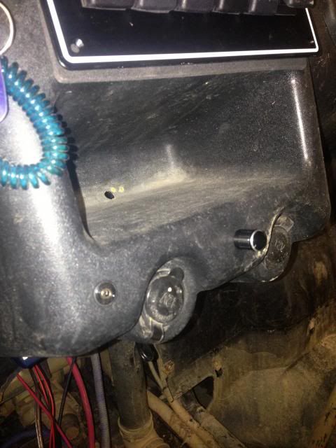

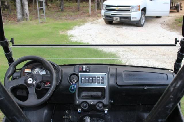

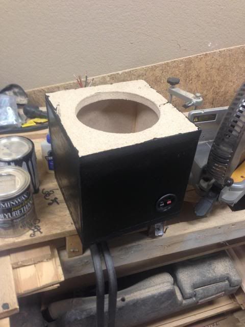

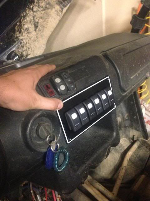

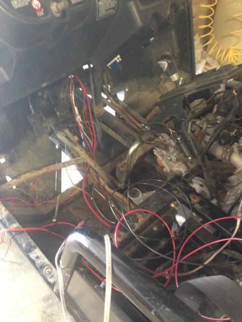

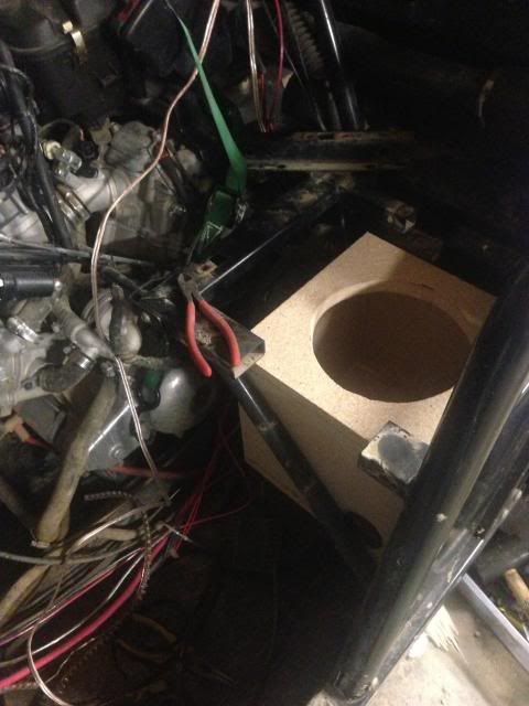

here is my progress, the box is a perfect 10"x10"x10" and fits tight and nice. I went with the polk 8" marine rated. Will use the bolts from the seat bracket to hold it up. Coated it in rustoleum black, then coating it in glass. Mounting the volume knob and input line on the dash along with my switch panel. also showed how i am mounting the 6.5" to the roof. Cut some sheet metal to weld in. more pics to come.

Turning out really nice,I like all your switches.:)
I love the overhead speaker layout. Really nice job! I'm curious as to how effective the under seat subwoofer setup will be. The more I thought about the box being tucked under there, the more I'm beginning to think the motor noise will be a lot to compete with. I could be wrong (and hope I'm wrong cuz it's a damn nice setup you've built). I'm assuming you're not going with a head unit and just running a AUX line to an amplifier and using an iPod or MP3 player for your tunes? Also curious on how you are setting up your battery (or batteries).
I am curious too how effect the sub will be, its really effective with it not running! but still dont have it all back together to see once you are driving around. May just be a butt massage. I am putting the heat mat under the center console for heat and sound so hopefully that helps. ALso got a second fan and exhaust wrap for that heat issue too! I will have it all complete today and will post some better pics.
I've heard of guys using 1/4" Dynamat to line the doghouse (engine cover). It's not cheap ($75) but I've read that it significantly reduces the engine noise and such. The nice thing is that Dynamat has a adhesive backing which makes the installation of it fairly easy once you get your cuts figured out.

Update: The overhead speakers work great, they will scream at you. The sub is only heard when you are sitting. The motor noise is so loud its hard to over come that. I used the heat dynamat under the doghouse, which was amazing in making it alot quieter in the cab and also not so hot. You can sit your arm on the doghouse and not feel the heat. here is some finish pics.
