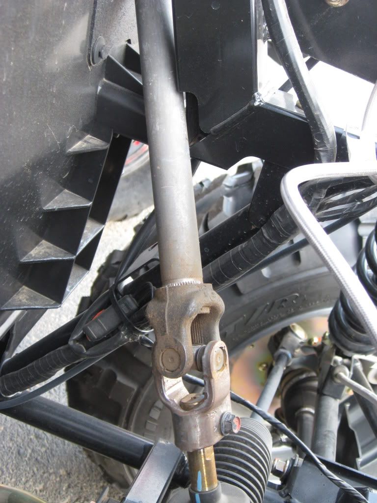

When I took delivery on my '09 Prowler 550 I drove it a round the dealers parking lot. Very stiff steering. Dealer said it was the concrete parking lot. OK.
Then when I get her back to home dirt it still just doesn't feel right. Checking, I found, about 6-8 in in front of firewall the shaft was rubbing a sharp support anchor on the frame upright. Shaft was already scarred all the way around with shallow groove. If the steering shaft is tubular (?) this could be a real dangerous problem if not corrected. Just a word to the wise.

Okay, checked with my technician and here's what he told me. Sometimes the steering shaft on the Prowler gets pushed too far down on the steering gear unit. This causes the angle of the shaft to change enough to allow the column to rub.
All that needs to be done is to loosen the bolt that holds the clamp tight on the steering column u-joint. Then slide the u-joint back up the shaft of the steering gear unit until the column clears the frame. Then reapply Locktite (red) and tighten the bolt back down. Hope this helps.

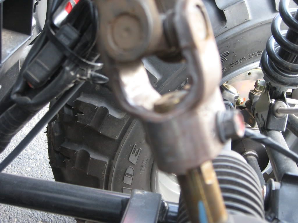

This is the bolt to loosen to slide the u-joint up:

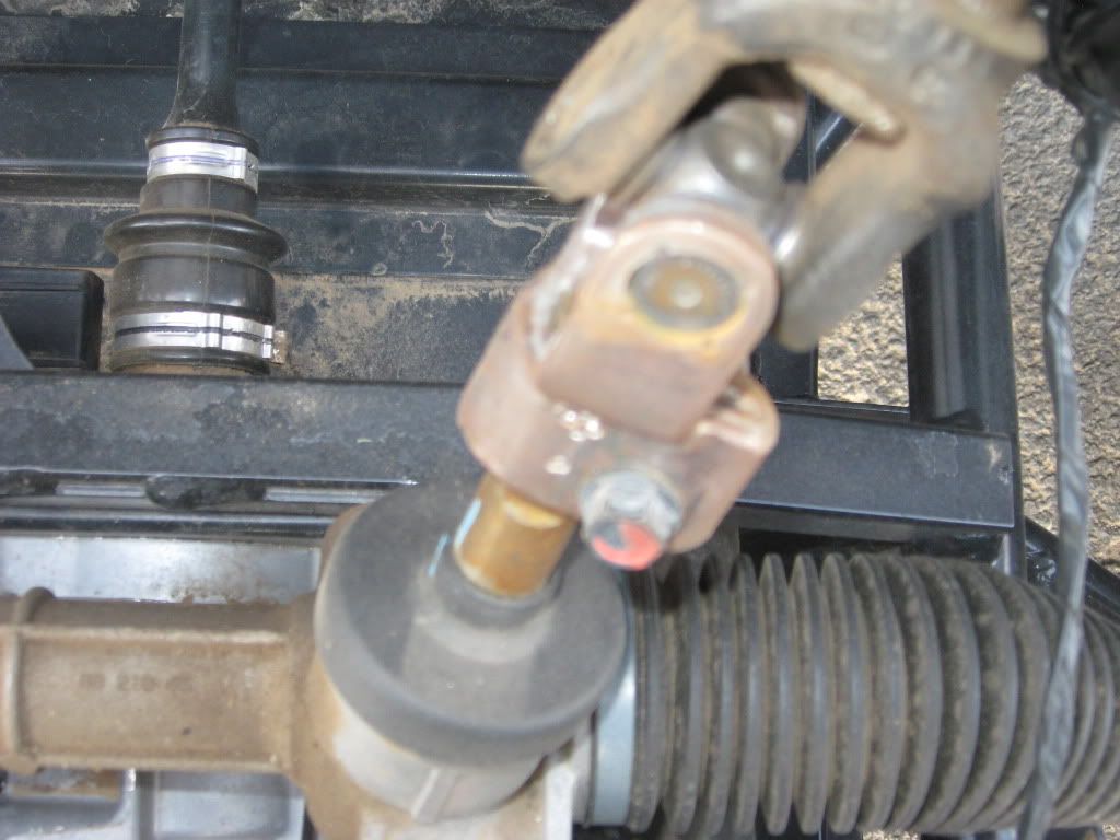

Here you can see how the u-joint can be adjusted up or down to change the angle of the shaft. Don't go too far up or you will make the steering harder.
